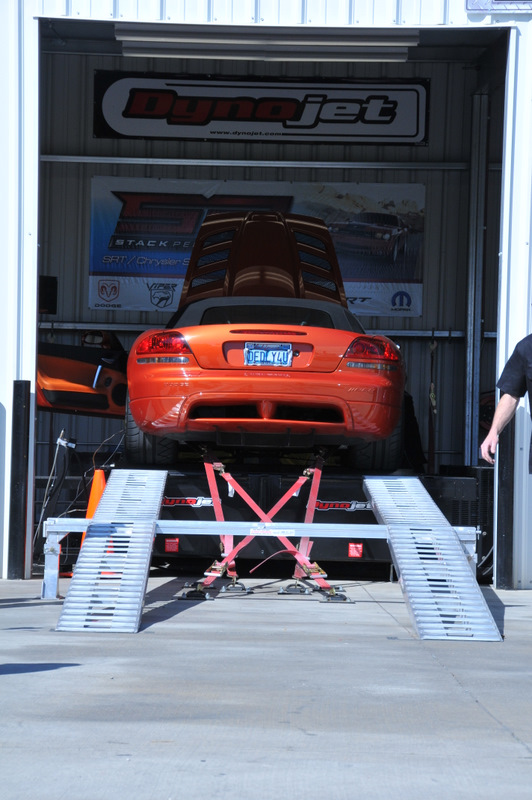

Mine 461 RWHP, 489 RWTQ

Here's how it came out between you, me and the Stack car (from memory):
Stack car, 595 rwhp, 575 rwtq, Belangers, Corsa Track 3.0 inch exhaust, Mopar ECU, stock tires / gear ratio, 114 decibles
Your car, 587 rwhp, 550 rwtq, Belangers, Magnaflow 20 inch muffler (Belanger 2.5 inch exhaust with 3 inch tip) stock tires / gear ratio, 114 decibles
My car, 576 rwhp, 550 rwtq, Belangers, OE 28 inch muffler (2.5 inch exhaust) 18 inch rear tires (equal to about 3.33 ratio - so some minor power loss there), 112 decibles.  92.4 degrees F on the dyno sheet during the run.
