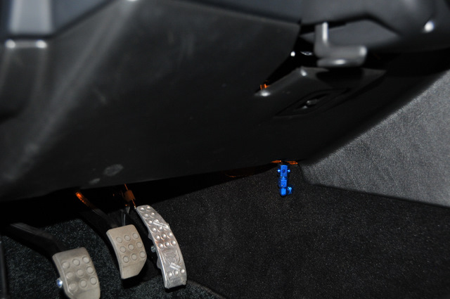

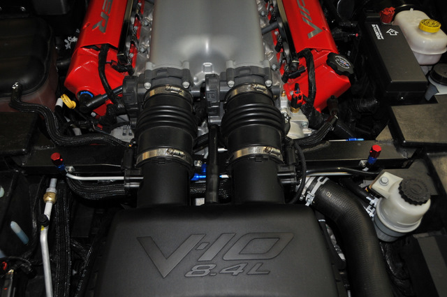

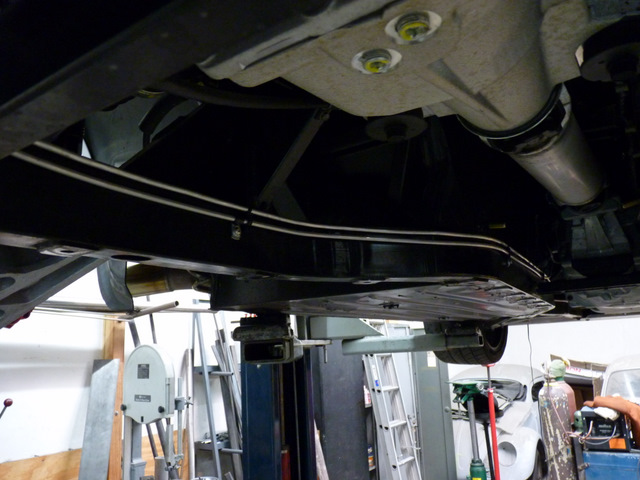

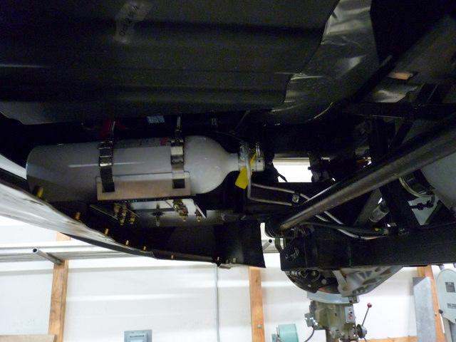

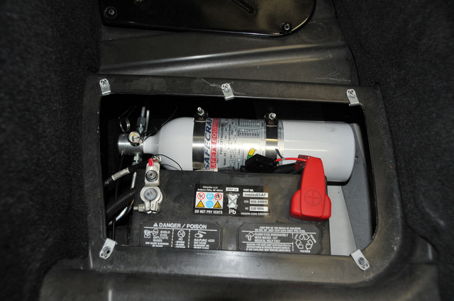

Hey Angel,
You can put the typical fire extinguisher that mounts right in front of the passenger seat. These usually run about $140 - 170 (I have one that I took out of my car I'll sell you if you want)
The best way to go is the plumbed halon system.
Bottle mounted next to the battery
Fire pull
hard lines to the front of the car
Engine bay nozzles
Nozzle in the foot well
Keep in mind that the fires systems are in the cars for the primary reason of giving you the added minute or two to get out of the car before it is totally engulfed in flames.  They generally are not designed to save a car from fire.

Hi Angel,
The fire "bottle" that mounts to the passenger side front seat "bolts" will satisfy most track outfits if you're just running time trial or lapping sessions but not if you are racing.
I ran with the bottle for quite a while and have fire bottles in Cathy's car and in my black convertible.  Just makes sense.
I had the Halon system installed in my ACR as Lance and others have.  Brian Kono did a very nice job.
I hope I never have to use it!
Dan  <19
