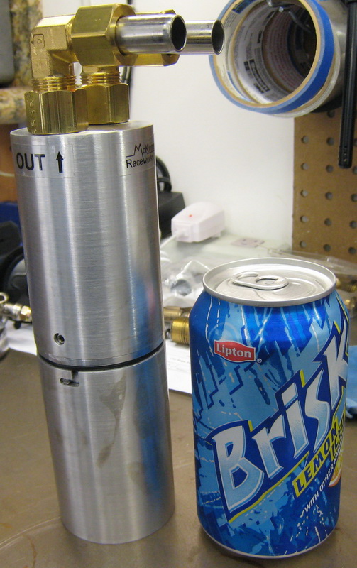

Balancing the great features with ease of install and simple regular maintenance while hitting the right price point is always a challenge, but the McKinney Raceworks Catch Can seems to have done it.  It is CNC milled from a solid 2.25" rod of 6061 Aluminum so it feels hefty and fitting under the hood of a Viper.  At 7 inches long and 2.25" diameter it is easy enough to find space for it to fit in the engine bay.  As a totally sealed design, it really allows the vacuum from the intake manifold to suck the air out of the crankcase.  They make several versions with the main differences being the size and arrangement of the fittings.  The 1/2 inch 90 degree fittings are the ones that will work best due to the Viper's low hood clearance.

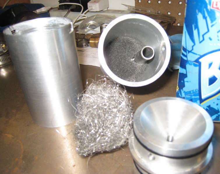

They always say its what's on the inside that counts and that is certainly what won me over on this one.  The "dirty" crankcase air enters in through one port and travels down a ½ inch tube inside the Catch Can.  As the vapors exit the tube they encounter a small gap between the exit tube and the funneled surface of the Catch Can's mid-section.  A lot of the oil particles will impact on the funnel surface of the mid-section and then drain down into the bottom trap chamber.  The radius turn into the next exit chamber is quite sharp so while the air can flow into it, the oil vapors will lose velocity making the turn and entering the larger space.  This will cause any leftover oil, that did not impact on the funnel surface, to drop out of suspension of the air stream.  They would then condense on the mid-section and drain down.  Now the fumes and vapors that made it into the exit chamber must pass through some packed steel wool which will act as a kind of filter media, further separating out any remaining oil vapors or gunk.  This all ends up draining back down into the bottom section.  And finally, a foam filter is the last barrier before the air is allowed to be re-introduced into the intake manifold.
The bottom section of the Catch Can is where all the oil that condenses on the funnel surface of the mid-section drains into.  The drain hole is a small port in the middle of the mid-section.  This also helps to act as a baffle to further prevent oil trapped in the bottom section from traveling back up into the upper chambers under hard cornering or braking.  And for ease of maintenance, the bottom section comes off with a twist and then you can just properly dispose of all the collected oil and particles.  Looking inside the "cup" one can't help, but think how all that oil and gunk would have ended up in the intake manifold.

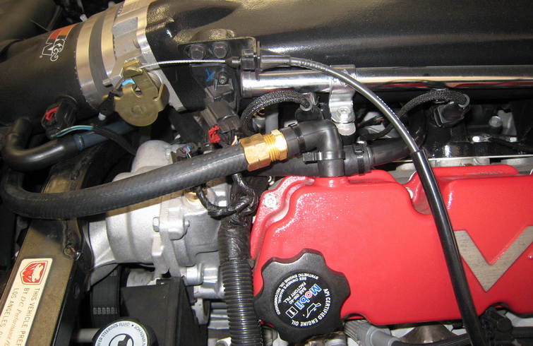

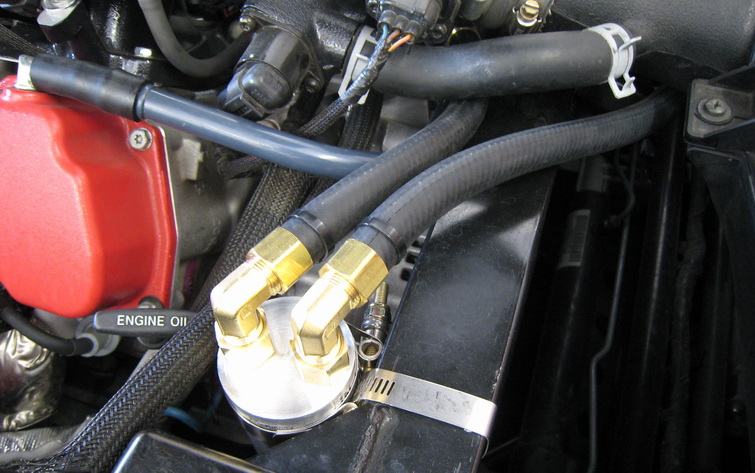

You could save a few bucks by using plastic barb hose fittings that already come in a 5/8" to 1/2" adaptor.  I was short on time and my OCD demanded that it be done before the next Viper Cruise, which incidentally was the next morning so overpriced brass fittings for me.  The connector coming off the intake manifold and the rubber connector off the driver side valve cover on my Gen 3 was 5/8".  The Catch Can fittings were 1/2" so this is were the fittings come in to size down the hose.  The 1 foot of 5/8" hose goes directly on to the plastic connector coming off the intake.  Then the 5/8" to 1/2" adaptor goes on allowing you to run 1/2" hose all the way to the "OUT" port of the Catch Can.  For the valve cover, you plug the 5/8" to 1/2" adaptor right into the rubber elbow.  Then you run 1/2" hose all that way back to the "IN" port of the Catch Can.

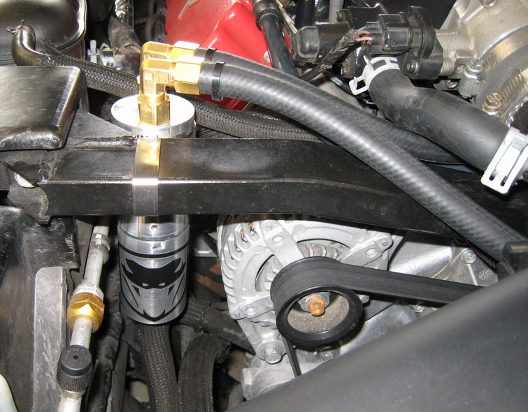

The T-bolt clamp is what you will use to clamp around the Catch Can.  I like the Murray clamps.  Sure you could use a worm drive clamp with the slots, but the T-bolt clamp looks a lot cleaner.  The worm drive hose clamp is what you will use to hold the T-bolt clamp and thus the Catch Can against the engine bay brace bar.  Be sure to get a good quality clamp of thick gauge.  I used the clamps made by Ideal.  Some of the cheaper brands will bend when you try wrenching down on them.  And for this you will be wrenching down good to get a tight grip.  Once the clamp is tight and there is little to no movement from the Catch Can, you may notice that the worm drive clamp is not flush against the brace bar.  Just get a block of wood and then hammer down on the clamp until it goes flush.
Take a look at the pictures for further details.

12 oz ice tea can for size reference.  I drank it later and recycled the can too!  After which to balance things out I drove my obnoxiously loud, heavily modified Viper in a very non-eco friendly manner.

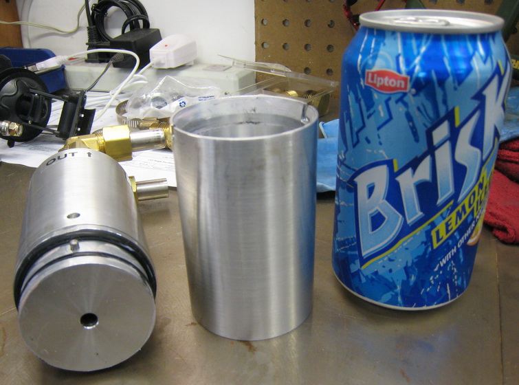

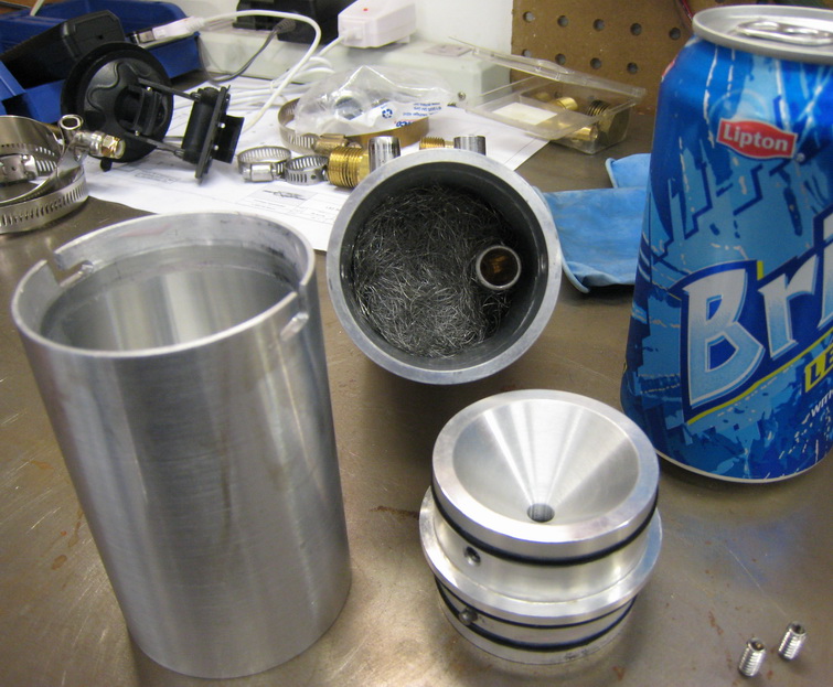

The bottom section twists off to easily inspect the contents and then dispose of any oil collected.  To the left you can seen the bottom side of the mid-section.  Notice the drain hole in the center.  This design prevents the oil from splashing up during hard cornering or braking.
" border="0
All 3 main sections apart.  The mid-section is held in by two screws.  The o-rings help to form a nice air-tight seal.  The funnel surface of the mid-section directs oil to all drain down the center.  You can also see inside of the top section.  Note the 1/2" tube that brings in the "dirty" air and the steel wool that the air must pass through before exiting the "clean" port.
" border="0
Steel wool removed and now you can see the final foam filter.

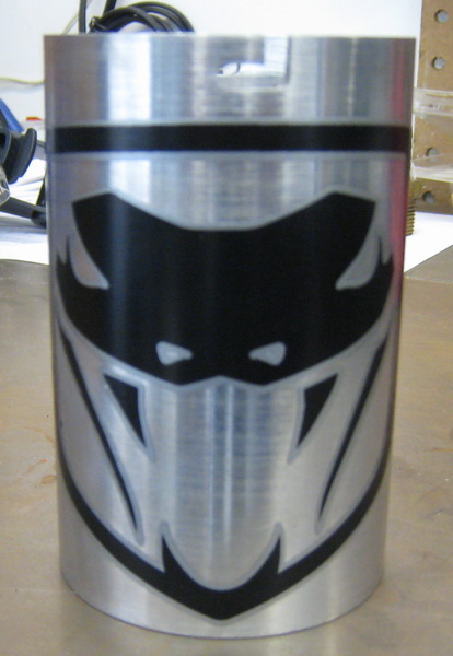

I couldn't resist and had to "church" it up a bit before the install.  Some polishing with Mother's Metal Polish and a Viper logo does wonders! ;)

Installed!
" border="0
" border="0
" border="0
" border="0
" border="0
" border="0

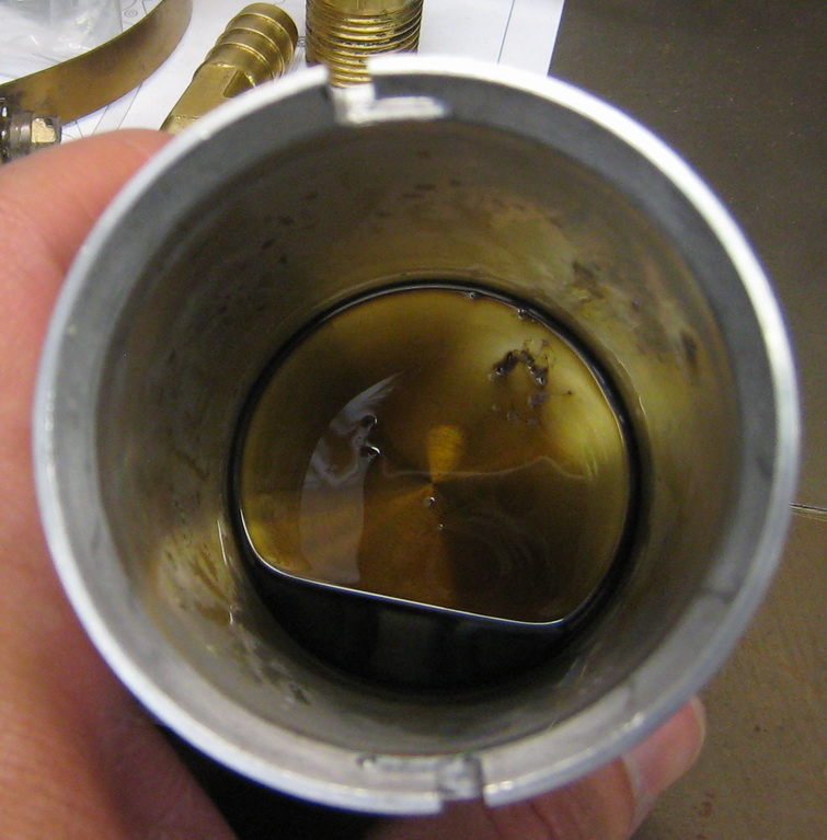

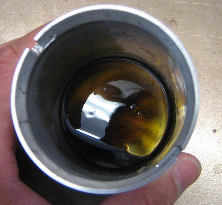

The Catch Can was installed the night before our Dukes Poker Run and was clean as a whistle.  Right after I got home I twisted off the cap and this is what I found.  That's a lot of oil and gunk!
" border="0
Now granted I did drive her pretty hard that day and I do have a big cam, heads, 11:1 compression etc. so you may not be pulling as much oil as I do under load, but daaaamn thats a lot of oil after just one day.  I'll have to check this thing at least 1 to 2 times a month.  For track days I will need to check her each day.
