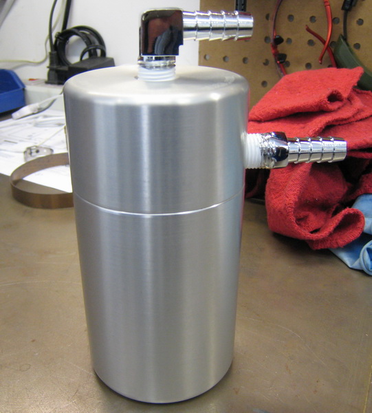

At 2.6" round and 6" long this catch can is a little wider and shorter than the McKinney Raceworks Catch Can.  The fittings are 3/8".  Oil vapor and fumes from the valve cover enter through the top port.  Clean air is drawn into the intake through the lower port.

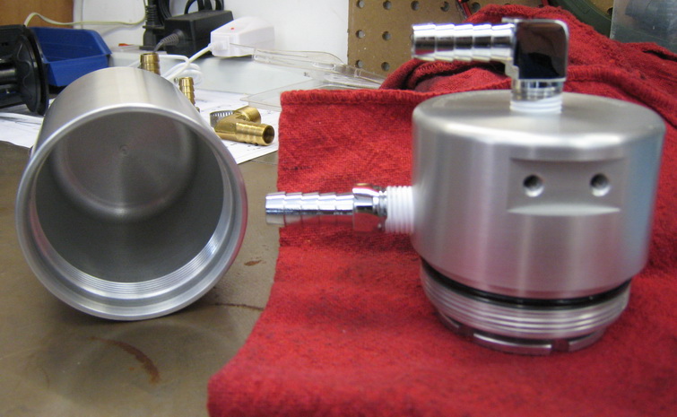

The bottom portion holds all the oil and unscrews for easy dumping.  Bottom portion is also O-Ring sealed. The backside of the top has two screw holes for the mounting bracket, but unfortunately this is more of a feature for the Corvettes since their cylinder heads have exposed bolts you can thread the bracket on to.  Not so on the Viper. The T-bolt clamp I used for the McKinney can will work here...though you would need a slightly bigger clamp due to the 2.6" diameter of the Elite Engineering catch can.

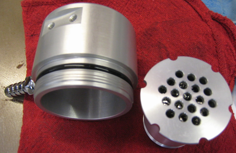

Here is a look at the oil separation chamber housed in the top half of the can.  Oil drains into the bottom part of the can through the holes.  Air is drawn into the intake through the gap and divots cut along the face.

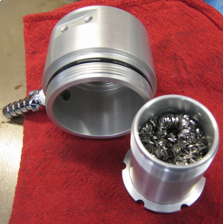

The oil separation chamber unscrews from the top.  Inside you find metal coiled shavings.  These act as the main separation medium.  Oil vapors and fumes enter though the top of the can and then must pass through this filtration medium.  All the oil and gunk condenses on to the metal coiled shavings while the air passes through.  Eventually all the oil finds its way to the bottom of the filter and then drips to the bottom of the can through the drain holes.  You will want to unscrew the separation chamber several times a year and spray some brake cleaner through it to rinse out the gunk from clogging up.
" border="0

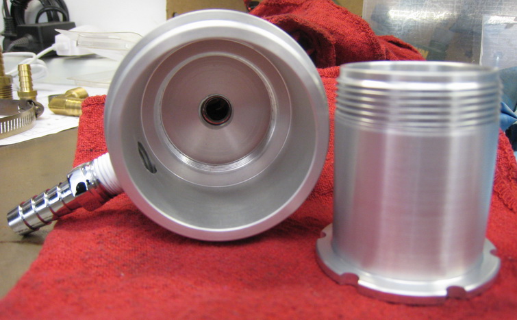

Side view of oil separation chamber unscrewed from top of can.

Bottom view of oil separation chamber.  Note the drain holes.  You can see the metal coiled shavings packed in there.  Oil drains through the drain holes, but air also passes through those same holes.  The oil and any vapors will not be able to make a 180 degree turn to flow into the clean air path above.
